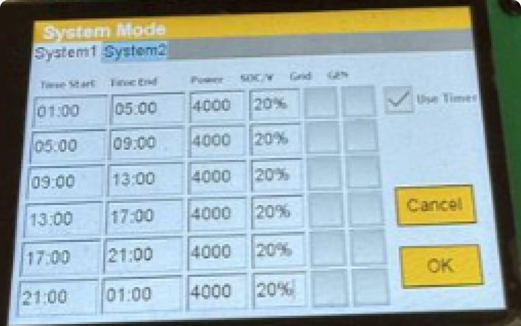

When customising time windows, they MUST remain in chronological order. The first window must always start at 00:30 or later. Failure to do so may result in system errors.

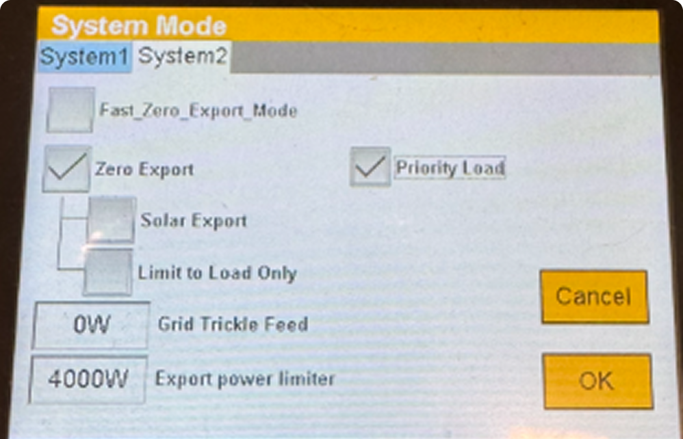

System 1 Image
System 1 Image
System 2 Image
System 2 Image
System 1 Image
System 1 Image
System 2 Image
System 2 Image
System 1 Image
System 1 Image
System 1 Image
System 1 Image
