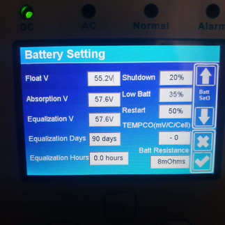

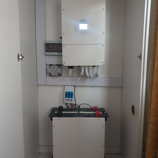

I'm not a fan of fixing someone else's subpar installation but I have to this time around.
Kindly advise on any pertinent issues your 'eye may spy"
Case info as follows:
*8kW Deye Inverter
2x 5kW Dyness Lithium
10 x 545Watt Canadian Solar
~Poor Location Choice of Inverter
~No "CT Sensor" installed (found in box on top of Inverter)
~Slave Battery has incorrect setting (1 2 ^3^ 4)
~No Earth Connections visible during Visual Inspection (still to open Inverter Cover)
~Entire Home is supplied via the Inverter Battery Supply
ie.
No Critical Load assignment. Entire Single phase Supply through Inverter
Installed Mid February
Electrical C.O.C issued
Thanks in advance
