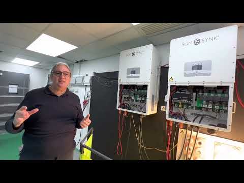

As promised this is the first video showing two Sunsynk 50 kW Hybrid inverters working together in parallel with a 120 kWh battery array...
As promised this is the first video showing two Sunsynk 50 kW Hybrid inverters working together in parallel with a 120 kWh battery array a double-headed monster
- The batteries can't have a common Buzzbar, they are wired separately with one inverter one battery
- Each Inverter has two battery ports 50 Amp Each (they can parallel on the same inverter )
- Use the BMS 1 Port on the inverter
- Ensure good BMS Comms
- Take great care with HV Batteries always use rubber gloves.
- Software Version MCU 3102 F051
- Currently Max in parallel 5
More to come next week
