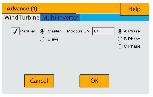

To configure multi-inverter settings, click on the 'Advance' icon.

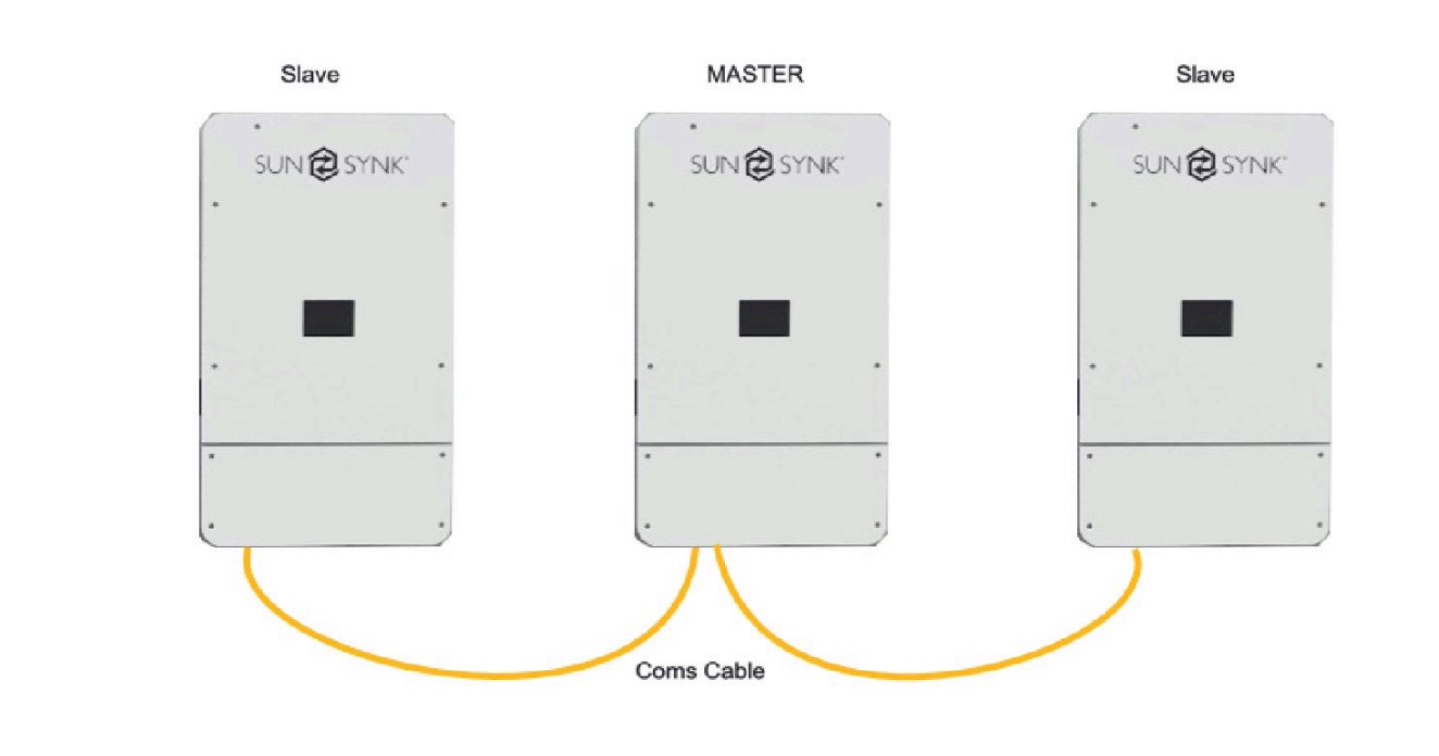

- 3) Ensure there is a good communication cable between each inverter and always set the Master Inverter centrally.

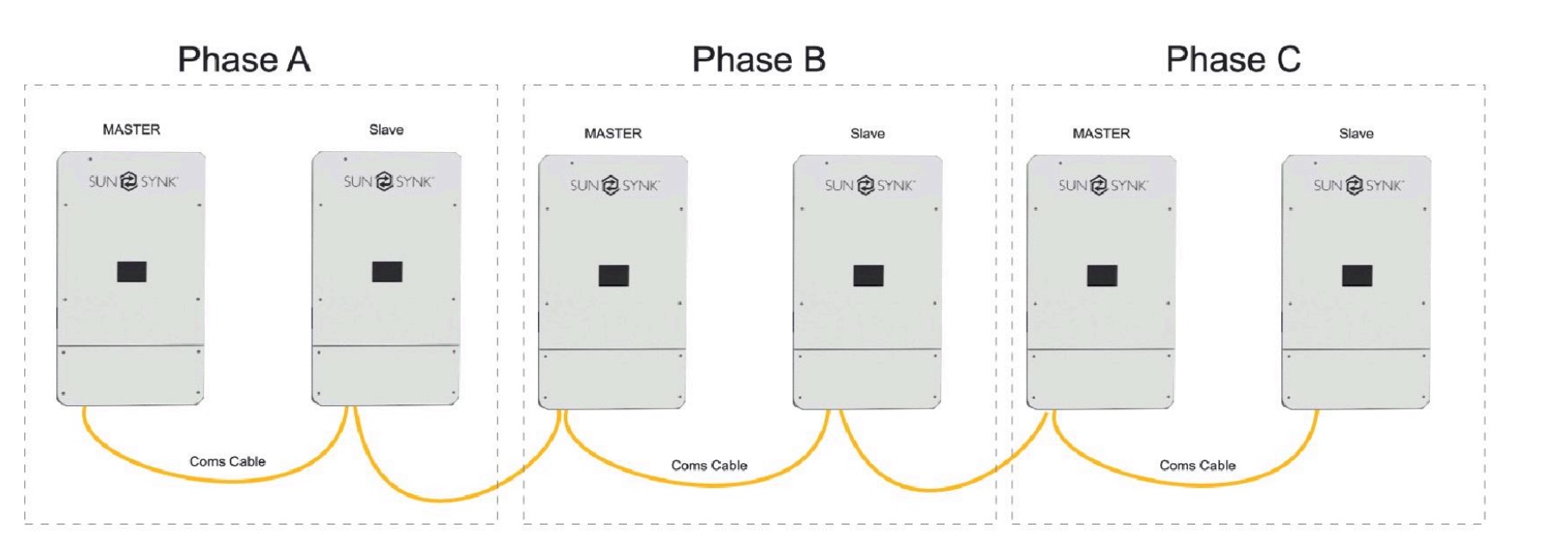

- 8) If using three-phase, you need three masters and three CT coils.

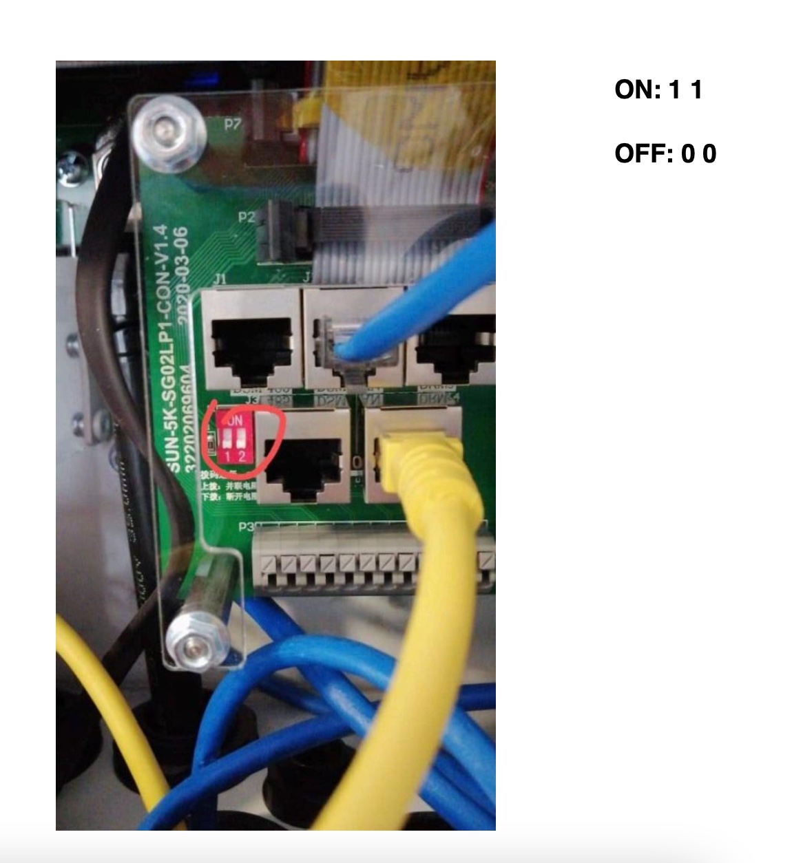

- 12) The most common problem with wiring inverters in parallel is the Communication Cable F29 Error. If using more than 3 inverters in parallel, you need to remove the resistors on the communication ports.
You can do this via a small dip switch located close to the parallel input,
SINGLE-PHASE CONFIGURATION the the 1) 2) 3) 4) 5) 6) 7) 8) 9) In theory, you can connect up to 16 inverters on a single-phase configuration, but be very careful about inrush current when switching on. You may need to add an additional contactor. The single-phase configuration only requires one master, and all the others are slaves. In addition, keep communication cable as short as possible. Check if all inverters have the same operating system and the latest software version and are the same model. On the multi-inverter page, select 'parallel' and choose the master, which is normally the central inverter. Ensure that you have good quality communication cable between the inverters. Set all the other inverters to be slaves. Each inverter needs its own unique MODBUS number. Each inverter needs its own data logger. You only need one CT coil, which is connected to the master. All batteries are wired in parallel. The master is the only one that communicates with the battery BMS. After checking and setting all this, you are good to go. As previously mentioned, the most common fault is a communication error between the inverters. Please study the previous Section 7 of this training manual.
7.2. THREE-PHASE CONFIGURATION The Sunsynk Hybrid Inverter can also be paralleled in a three-phase system with perfect phase rotation. In this case, you need to have three masters, and all the others are slaves. DO NOT forget that each inverter still needs its own unique MODBUS communication number. ◼ Phase A: Master A and Slave A ◼ Phase B: Master B and Slave B ◼ Phase C: Master C and Slave C

- 4) Replace the communication cable with shorter cables. If possible, ensure that the middle inverter is the master and the other are slaves, which keeps the communication cable as short as possible.
- 5) Check if the port limiting resistors are set correctly.
