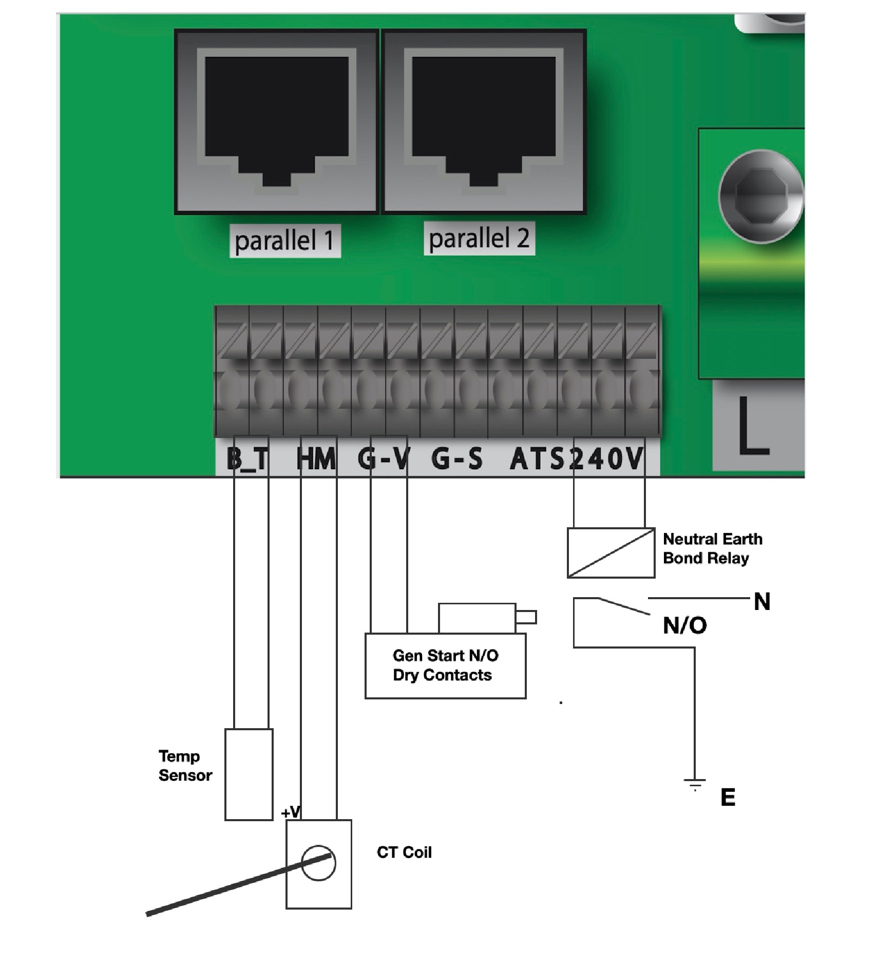

1 Set the % or V level when you want the generator to start. ( See the video below ) 2. The generator will automatically stop when the...
2. The generator will automatically stop when the battery is 95% full which is controlled either from the BMS of a lithium battery or the settings of the AGM
