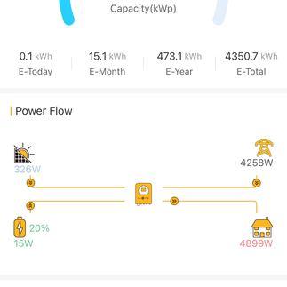

You might want to check the values that are being reported to the app and the inverter screen.
Since the update, both app and screen are showing a 320 watt deficit between what is being demanded by the house and what is being delivered by the combined solar, grid and battery.
The house appears to be demanding more than is being supplied!
I've raised this with Sunsynk who are investigating but despite the evidence they don't appear overly concerned.
It seems to me however, that if you can't believe the information displayed at the main screen, the integrity of all of the stats are in question.
Maybe it's only my system, a 3.6kw hybrid. If you've had the update applied, maybe you could check and comment below...

Update..Sunsynk have applied a fix. The difference is now only 30 watts, the difference between what the house is drawing and what the battery, grid and solar is supplying!
On a more positive note, the system powered off and recovered as hoped without the RCD trip as experienced by Matt.
