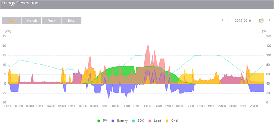

I have two questions related to this post of Rudolf and the example that Leon Malan posted.
My settings are the same as Rudolfs and all works well, except that my nonessential load (six Geysers 4KW/geyser) is exceeding the capacity of my setup, and i need advice on my Grid Peak Shaving settings.
2x 8Kw Synsynk Inverters
4x 5Kw Volta Batteries
24x 540w Pannels
The installer set the Grid Peak- shaving to 8000w under Advanced Settings. Limiting the grid load to 8000w. You will notice on the load graph that the grid load will not exceed this limit.
Questio one: I would like to know if the Grid Peak- shaving can be increased say to 12Kw during the day time on this setup?
I would prefer to reduce the high discharge on the Batteries, and is willing to rather utilise the PV and grid instead of stressing the batteries.
Question 2: What power should my PV setup deliver?
What PV power should 24x540w panels generate during normal sunny weather. (12.96Kw less 10% for lost which would allow at least 11.66Kw?
My current PV peak for July is ± 9,4Kw which is only 80% of the PV potential.
My highest measure since the installation end January 2023, was for a very shot spike of 10.39Kw (measured 13 February)
Are there any settings that might limit the PV from its full potential? Any other advice will be appreciated. I have even washed the panels and that did not make a huge difference as it was only slightly dusty.
Your assitance will be highly appreciated.
Regards Werner
