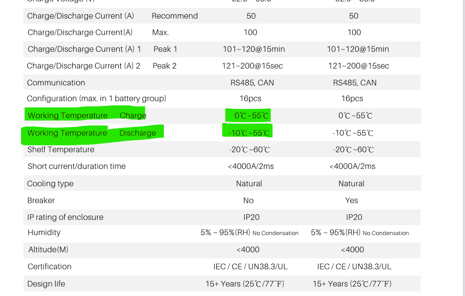

data sheet shows below. I'm sure it's the battery temp trottling your charge and discharge Amps
