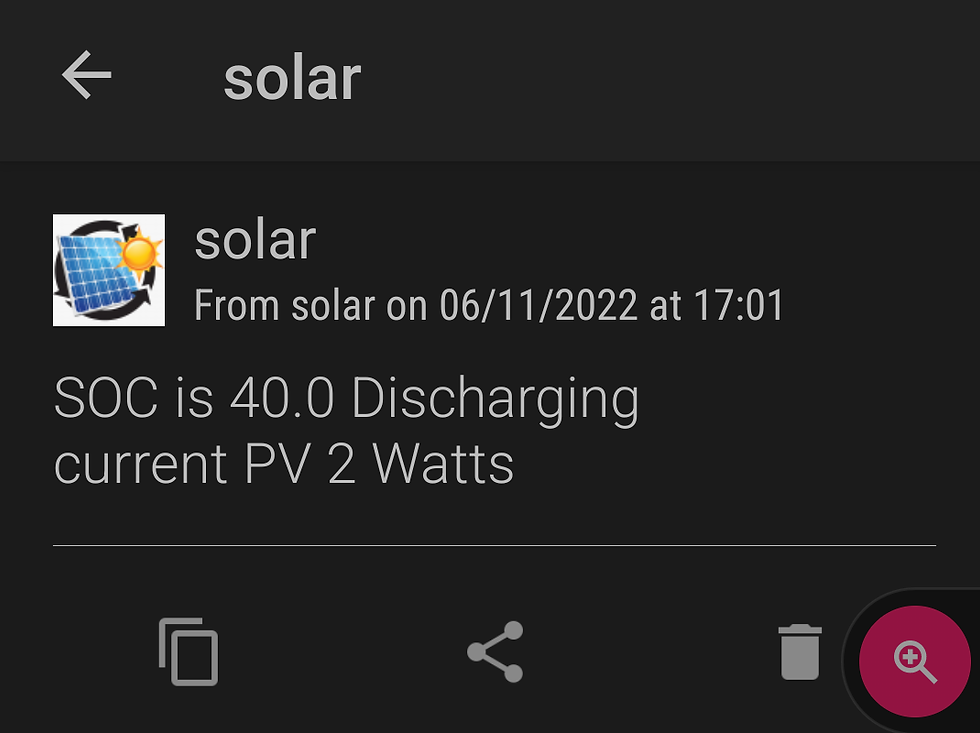

if you just want to access the same information in the app you can use this https://pydigger.com/pypi/sunsynkloggerapi you just need a python script rather than investing in other kit connected directly onto the inverter. I managed to get it to send me the SOC every hour via a push app https://play.google.com/store/apps/details?id=net.superblock.pushover to my mobile. Screen Shot below. excuse the noddy icon :-)
