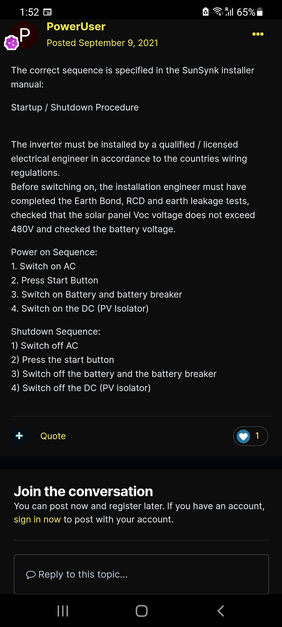

Hi, when connecting the inverter battery input do I need to pre-charge this inverter via a resistor first or is it ok to connect the battery bank and then turn on?
Thank you
