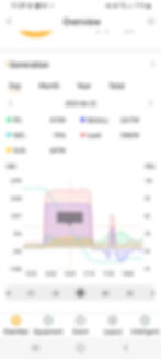

I have a sunsynk 3.6kw inverter and a 5.1kwh Sunsynk battery. When i have a high load the battery will limit its output to 2.6kw (50A).
i have set the battery discharge current to 85A.
When i check the battery values on the inverter (LiBMS) its set to 50A
any advice would be helpful
