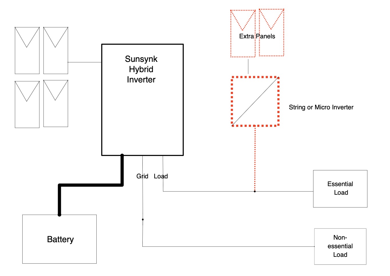

Please find a copy of the Sunsynk Micro and String Inverters. These are all fully compatible with the Sunsynk hybrid Inverters and could be AC-coupled with your existing system to give you more power by allowing you to add extra panels onto your system by AC coupling, either on the Load or the grid side of the hybrid inverter.
Adding a string or a micro-inverter can charge the batteries or supply the Load in an island or non-island mode.
For island mode, we recommend no more than 50% of the rating of the inverter for the none island mode you can go as big as you like ( Subject to Grid code compliance )
